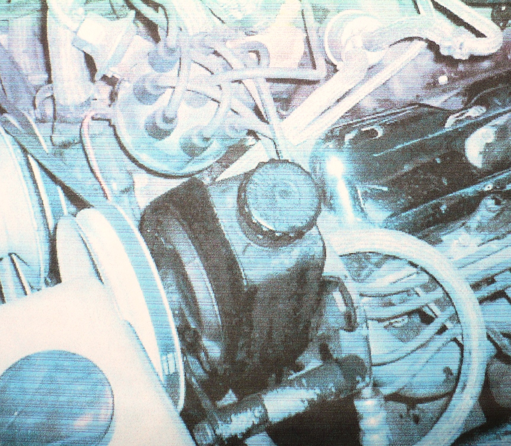

So, when I first got 'BB' she had an unmolested ignition system, this seems to be for the 1978 V8 motor, by the service manual.

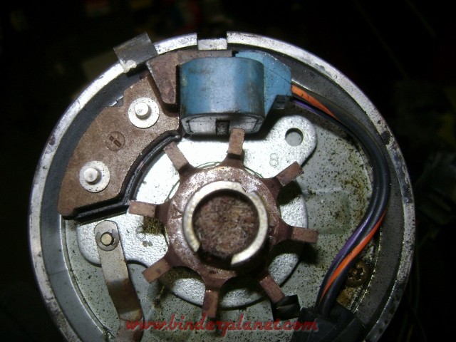

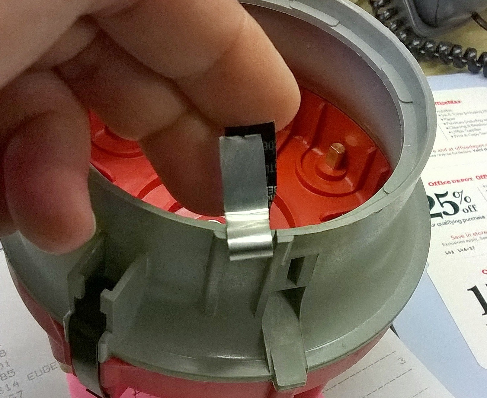

From one of JeepHammers fine threads;
V-8 DISTRIBUTOR UPGRADES WILL NEED A DIFFERENT ALIGNMENT TAB FOR THE UPGRADED CAP!
This is VERY easy to do, I usually use the side of a pop can, a razor knife or tin snips and needle nose pliers...
These are graphics showing what the alignment tab looks like, were it goes on the distributor to keep the cap adapter in the correct location.
The screw hole is in EVER Jeep/Motorcraft distributor, so there is no drilling or threading on the distributor,
You simply cut/fold the tab and install it.

I searched my local go-to wrecking yard to find an O.E. alignment tab, but it seems that they moved out the full sized Fords since last year and are now specializing on import cars.

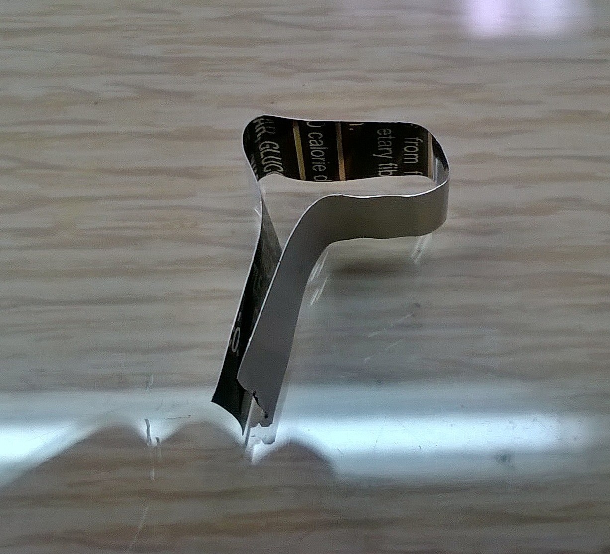

Last week someone dropped a "Wired" drink can outside of the office so after rinsing off I cut a blank out of the side to make that Locating Tab but it seemed so flimsy that I'm dubious it'll suffice. Maybe a soup can??? Has anyone else tried this?...

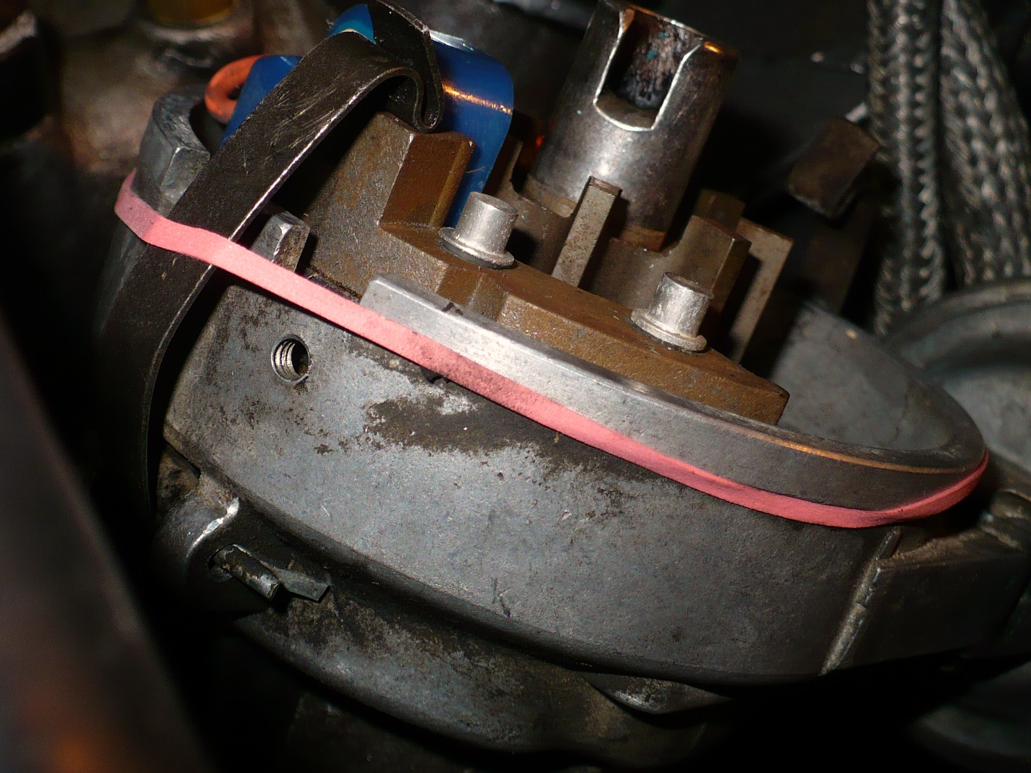

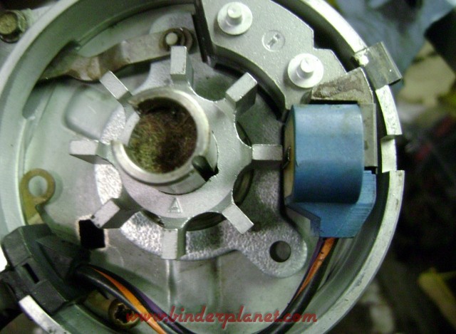

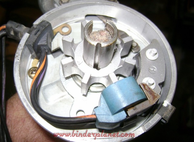

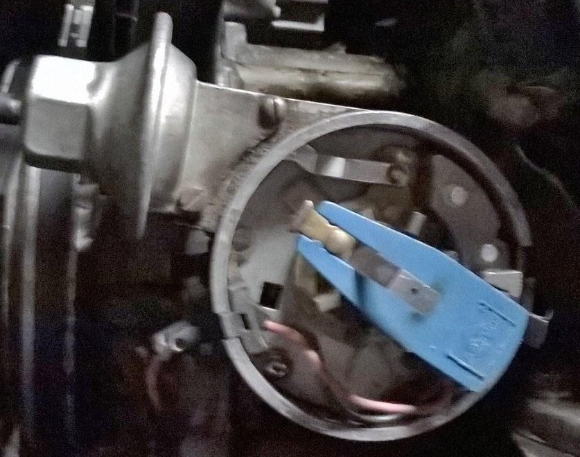

Thanks a lot Terry, Last night despite dealing with the crud since two days ago I popped the hood and pulled the distributor cap and like JH's photo above I found the Alignment Notch but where that Alignment Tab goes I couldn't feel a screw hole but there was another notch about an inch away from the Alignment Notch as what may be in that photo.
This one is mine
If I feel up to it I'll break out my signal mirror left over from my Marine days and see if I can spot that dang hole in those close quarters.

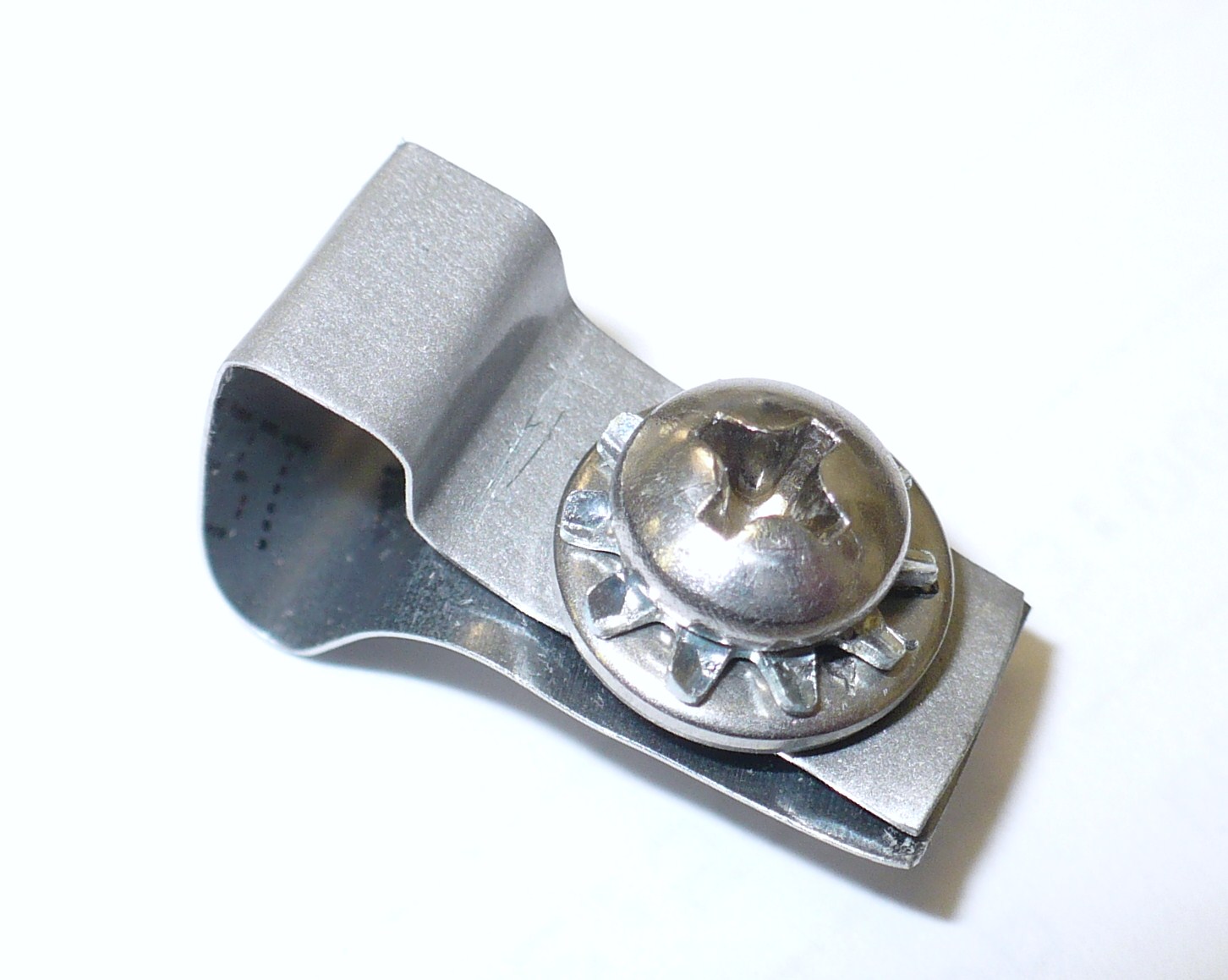

Well the Cap, Adapter and Rotor earlier than I thought, I quickly fabbed up that pop can retainer clip but I think I'm going to hunt for something more substantial.

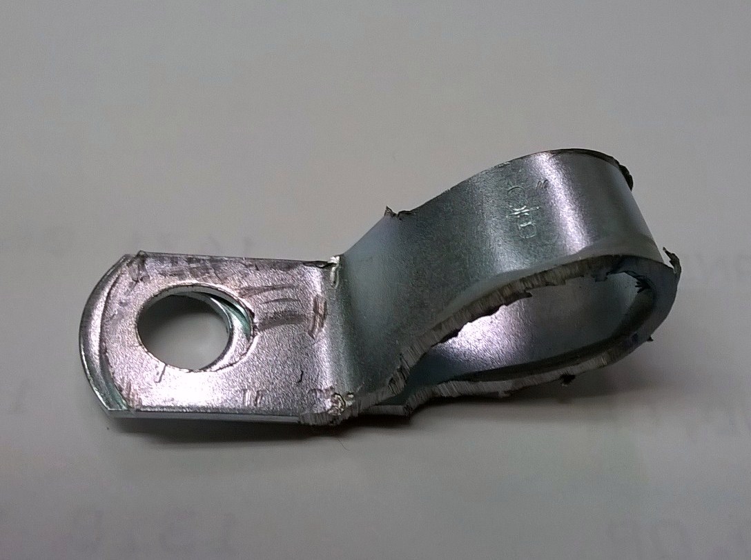

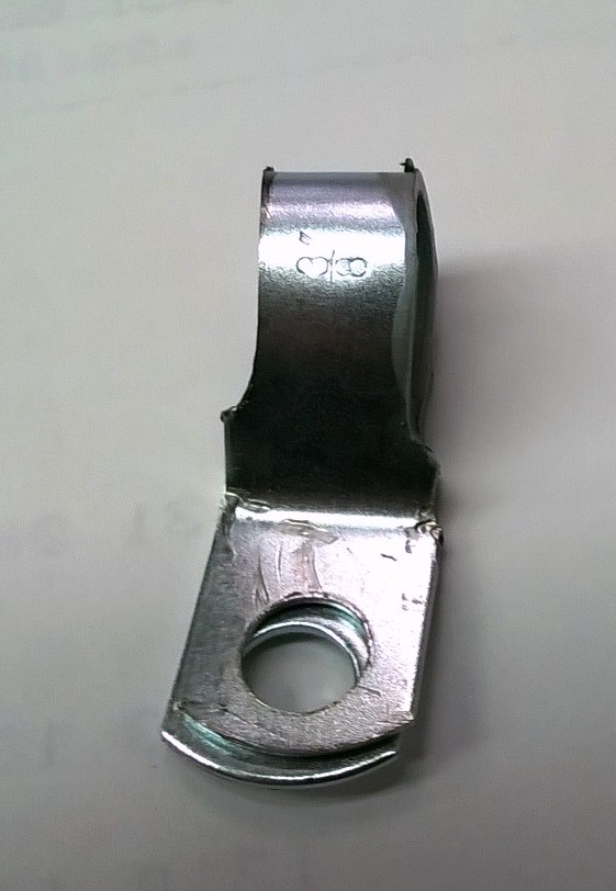

After four local shops I finally found a metal cable clamp that I can modify that'll fit the groove of the Distributor. After all that I was surprised to find that cable clamps aren't as common as I thought.
Finally I went to home Depot and found a pkg of 3/8 cable clamps, of course I had to find them myself because the hired hands were too busy kibbutzing to help me find 'em. A couple of minutes on the bench girnder and I have clearance for the cap notch. I've just got to deburr the dingus and bend it to spec. :)

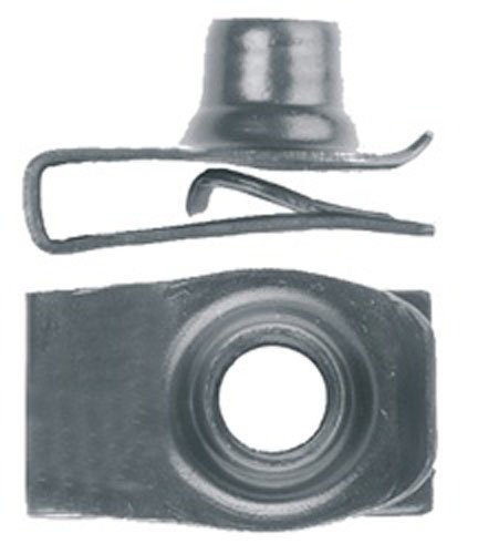

NOW I've just have to find a set screw and star washer to hold it in, does anyone know the thread and pitch?
yesterday during my short break I got out the Adapter and noticed that it fits very snugly, good news that as I've heard from some that theirs wobbles.

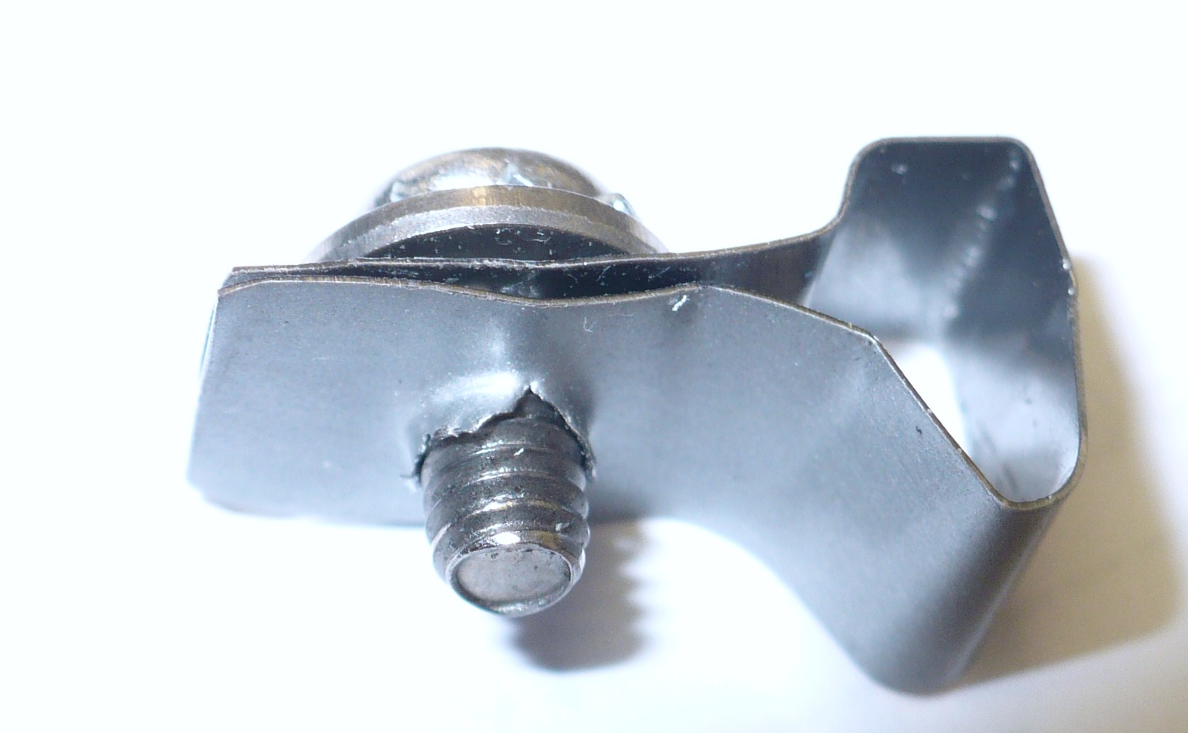

Out of a bag of screws I found the one that, with the help of some CRC Lectra-Motive and cutting fluid it threaded right in. I went to drill a hole for the set screw (10/24) into the pop can Alignment Tab but I jumped up sizes too quickly and destroyed it. I still have the one I'm grinding down from a cable clamp and taking my Micrometer I measured the Alignment Notch and the notch in the Adapter so I can get that tab as close as possible.

With my calipers I measured the following;
Distriutor Notch width .364"
Adapter Notch width .364" X .210" height
...and with the Adaprter mounted the gap measured about .0125"

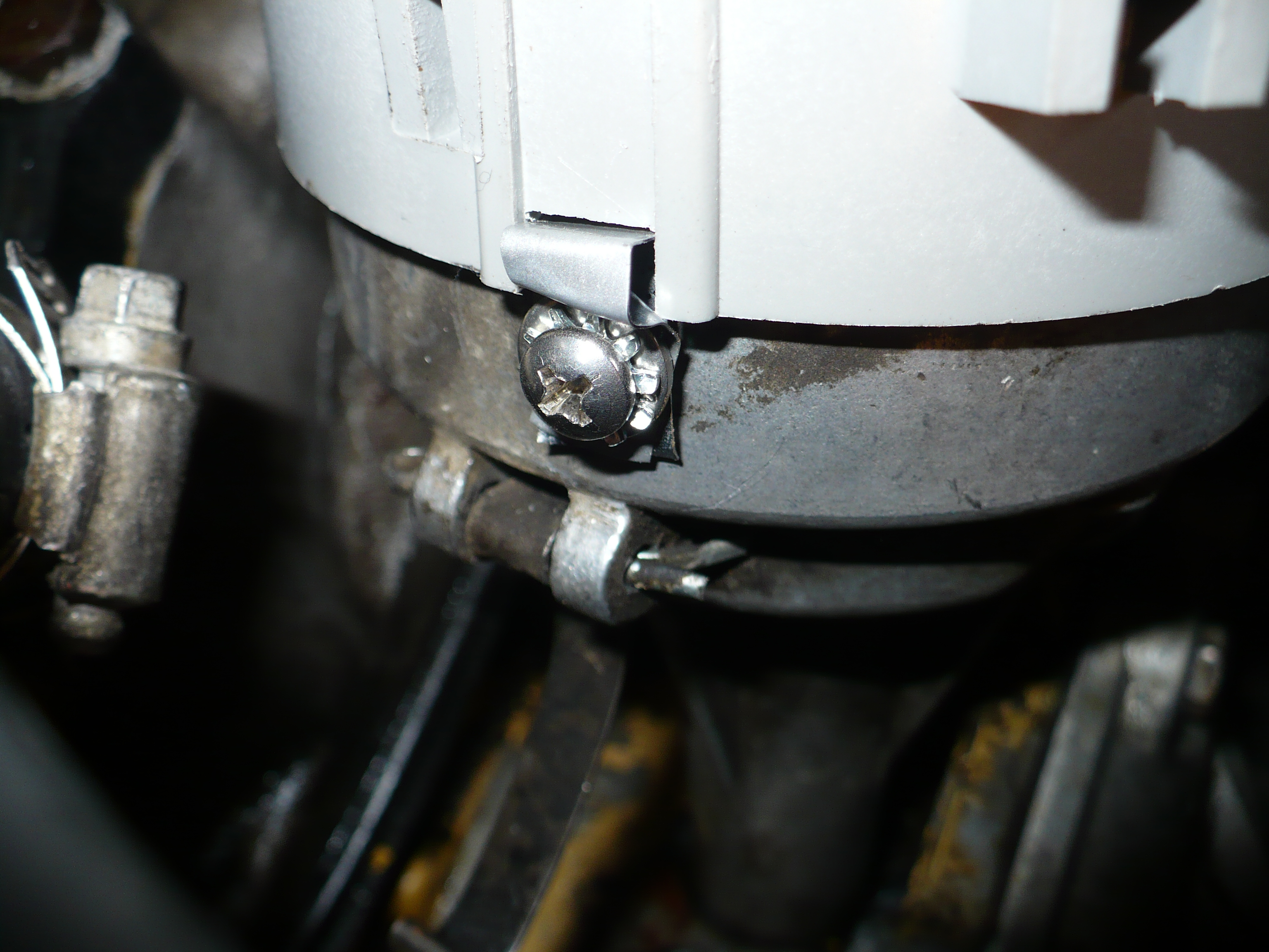

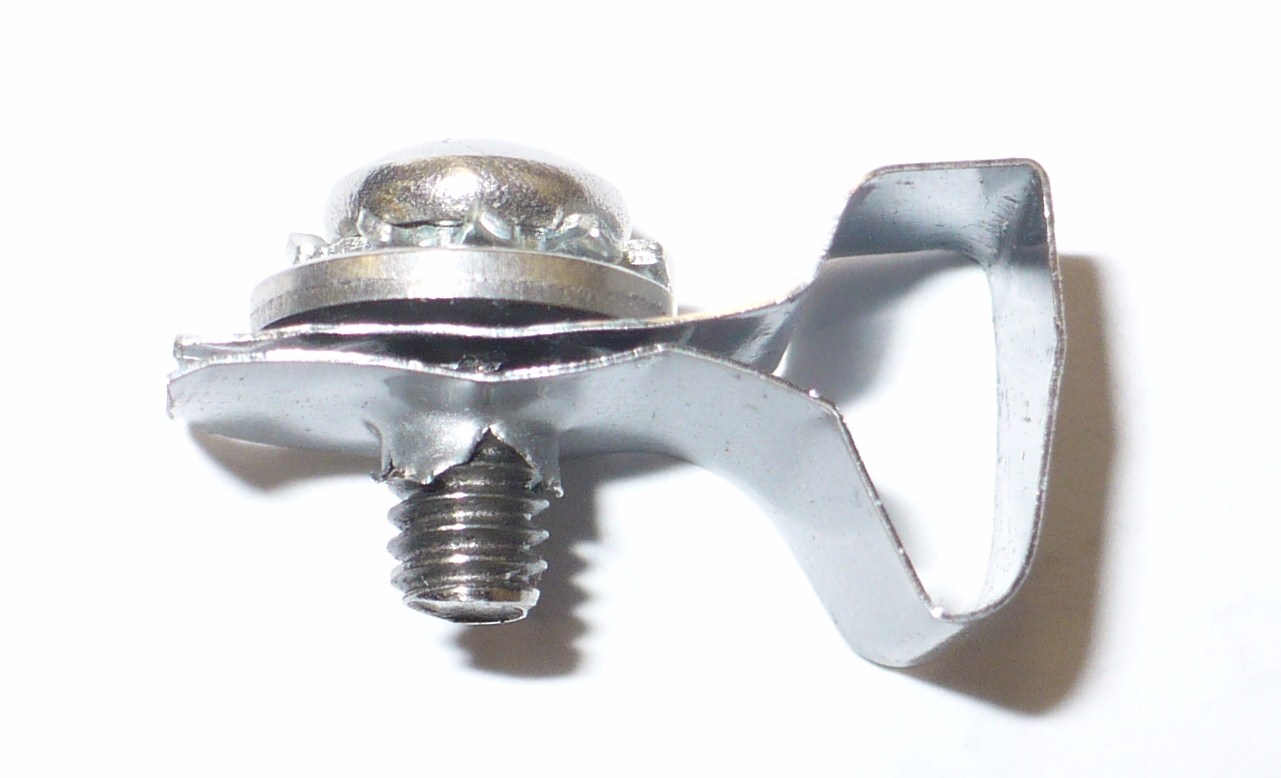

It may not be pretty but with my fumbling fingers, this is what I came up with;
If I'm not burnt out from work I may try this dingus tonight.
I test fit the dingus and those measurements translated well;
It fit so well, I installed the Adapter and it seems I'm on my way. :)
