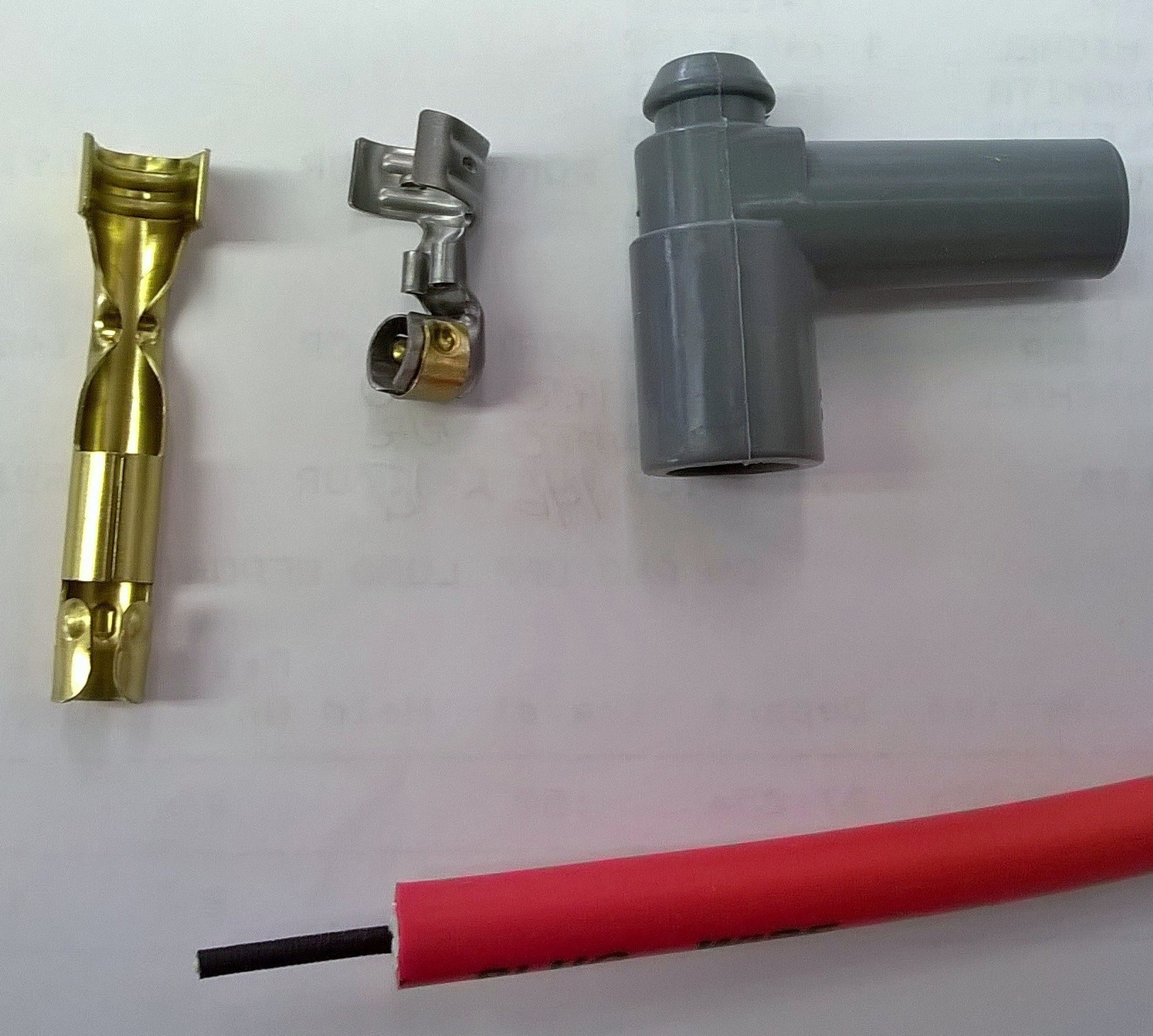

So opening the kit I found two styles of crimp terminals;
These terminals are described as the bronze colored Standard, and the silver colored Dual Crimp
I'm using the MSD Cap-a-Dapt and I believe the 90* Dual Crimp is what I shound be using, or could I be wrong?
I finally got through to the MSD Tech line and it is the silver double crimp for the Cap-a-dapt caps.

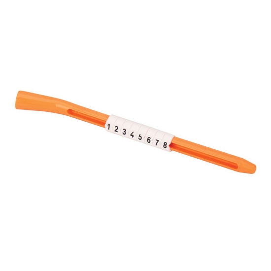

One thing not mentioned in the instructions was the wire labels ~ Note: It's much easier to slip these on before crimping the terminals on.

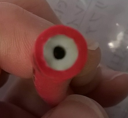

...another tip: When stripping the wire using the sizing crimping block included in the Universal Set use extra caution NOT to cut the Helically wound copper alloy conductor #8
I found out the hard way and ruined two wires.
Yep, I was better served by using the method I used on those old school Accel wires, with a steady hand and a razor blade.
This is Important

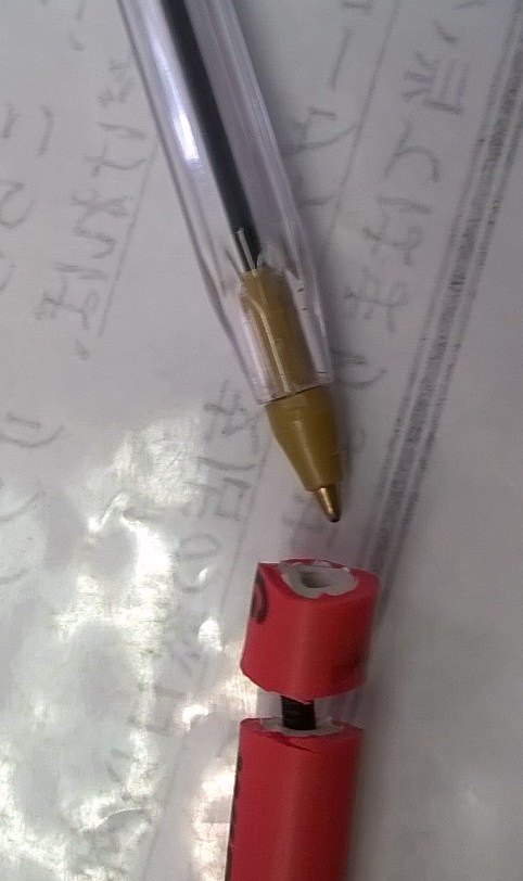

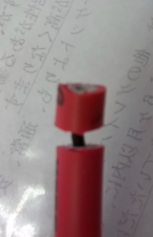

When stripping the wire to expose the conductive strands it is nesessary when pulling the outer shielding from the wire to be pushing the core oppositely. The reason for this is the core strands are so tightly enclosed by the inner sleeve it can become unraveled leaving you to cut and start again!
I used a ball point pen to poke through and it worked well.
On the first wire I tried for cylinder #1 it got roached to the point that it was too short. The good folks at MSD though siad they'd send me a new wire cut to length and all set up. These guys are on my 'great' list.

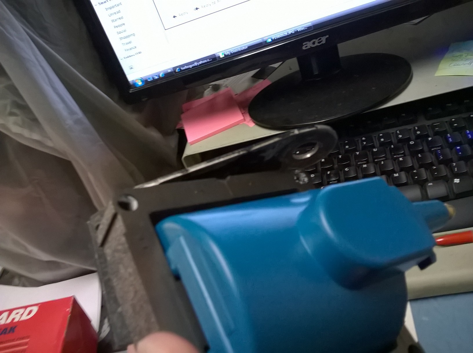

I just bought a Standard Blue Streak FD 478 coil and hopefully 'Black Betty' will be on the road again soon. :)
Thanks Terry, I fired off a PM to him. Have a great weekend!

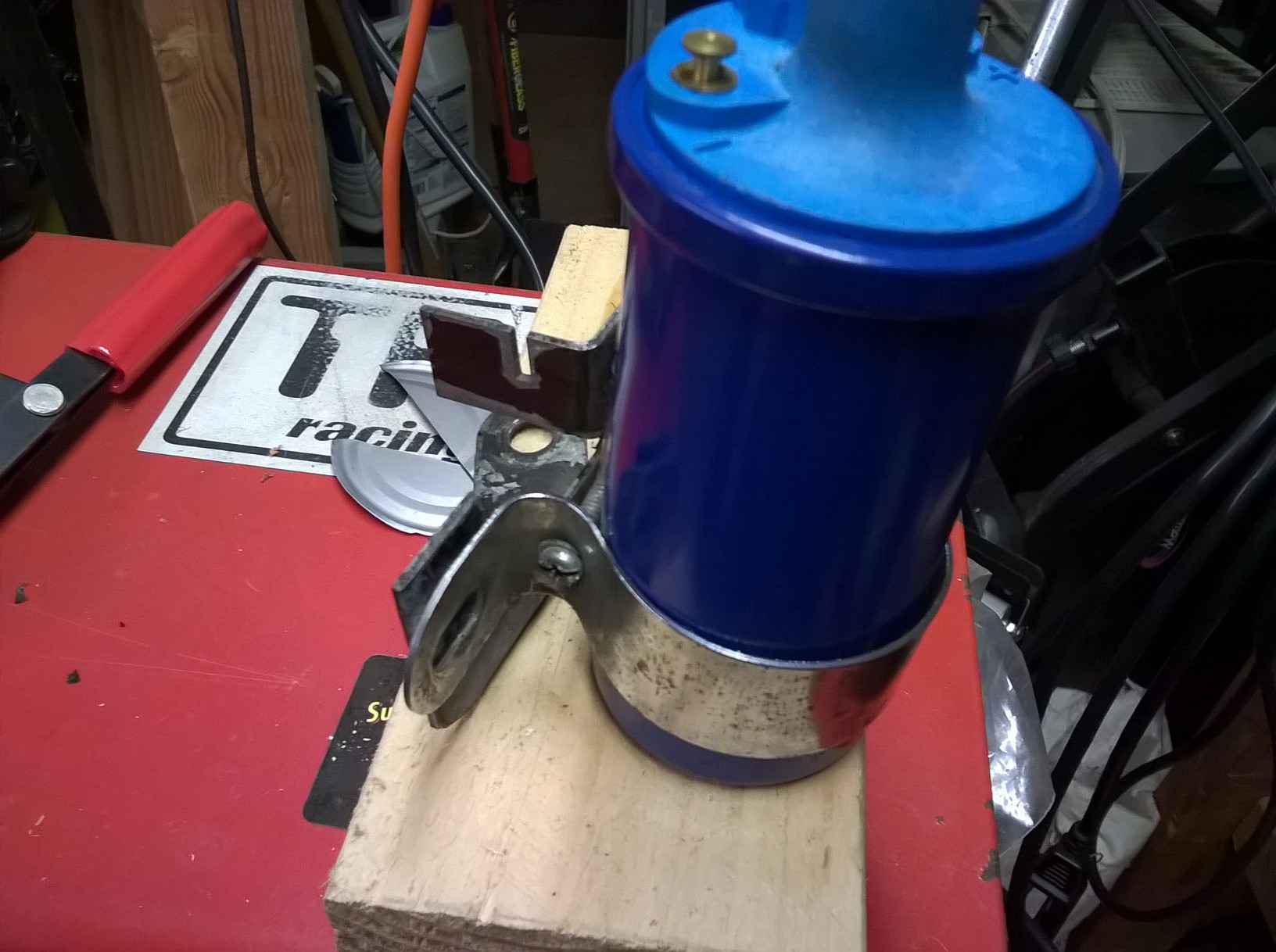

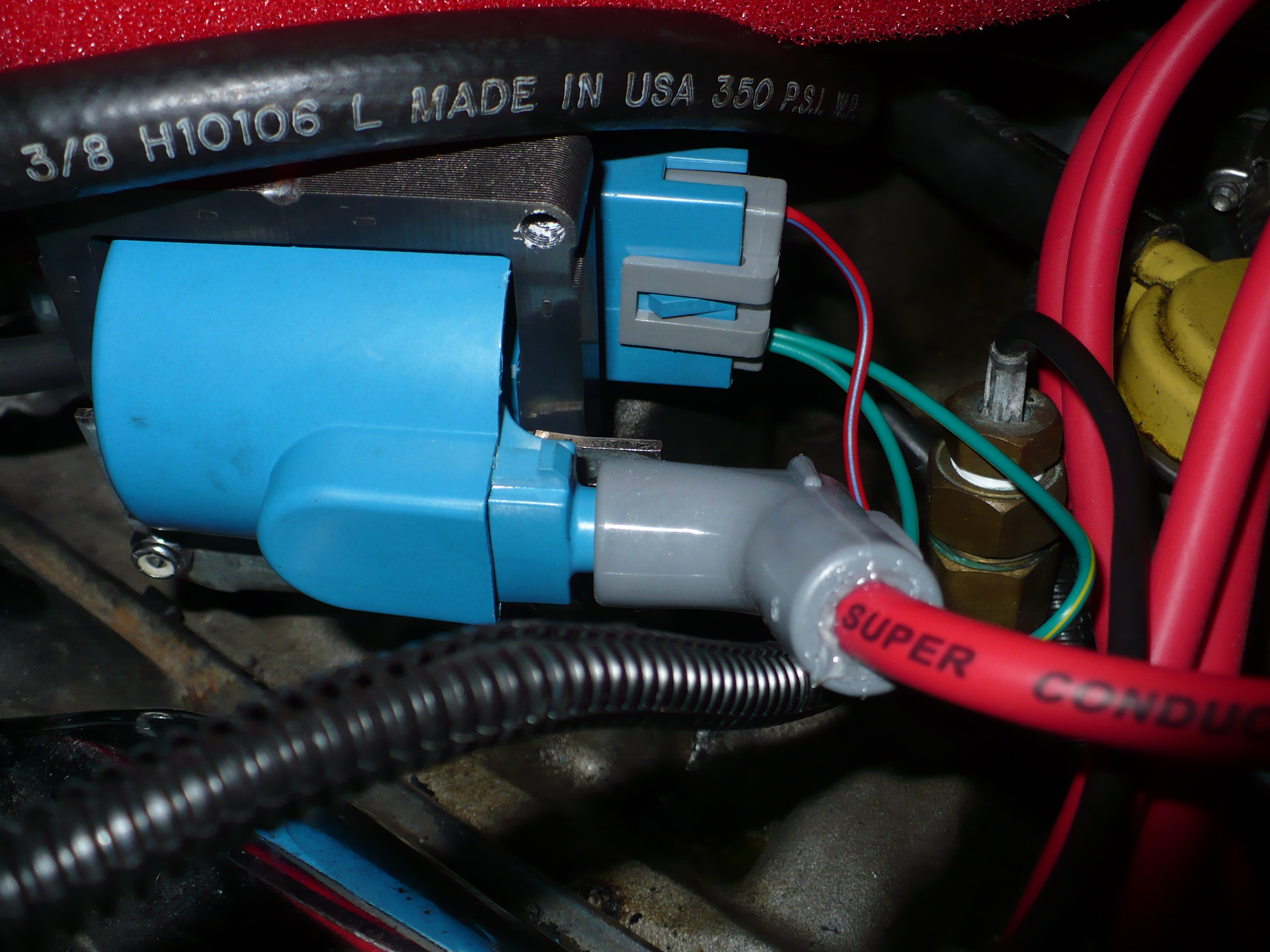

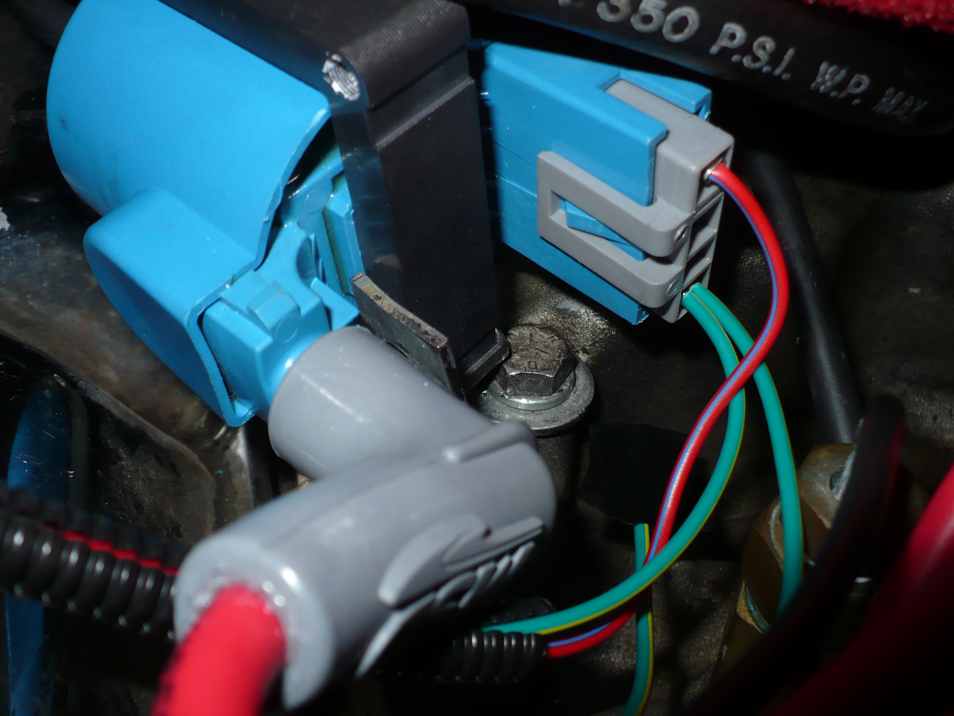

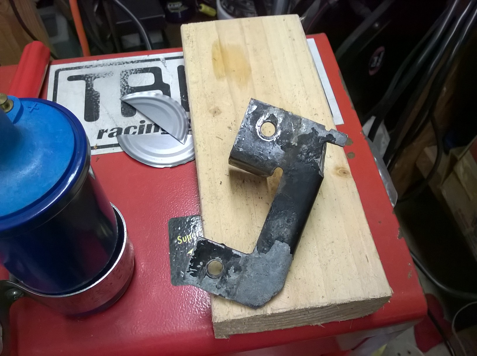

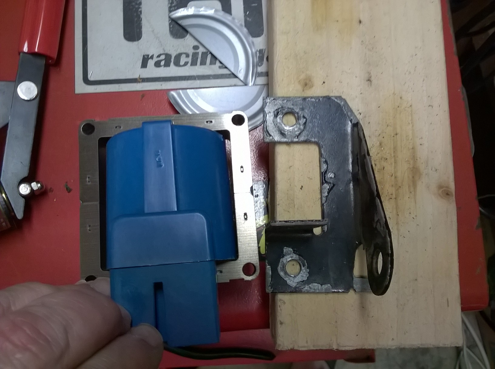

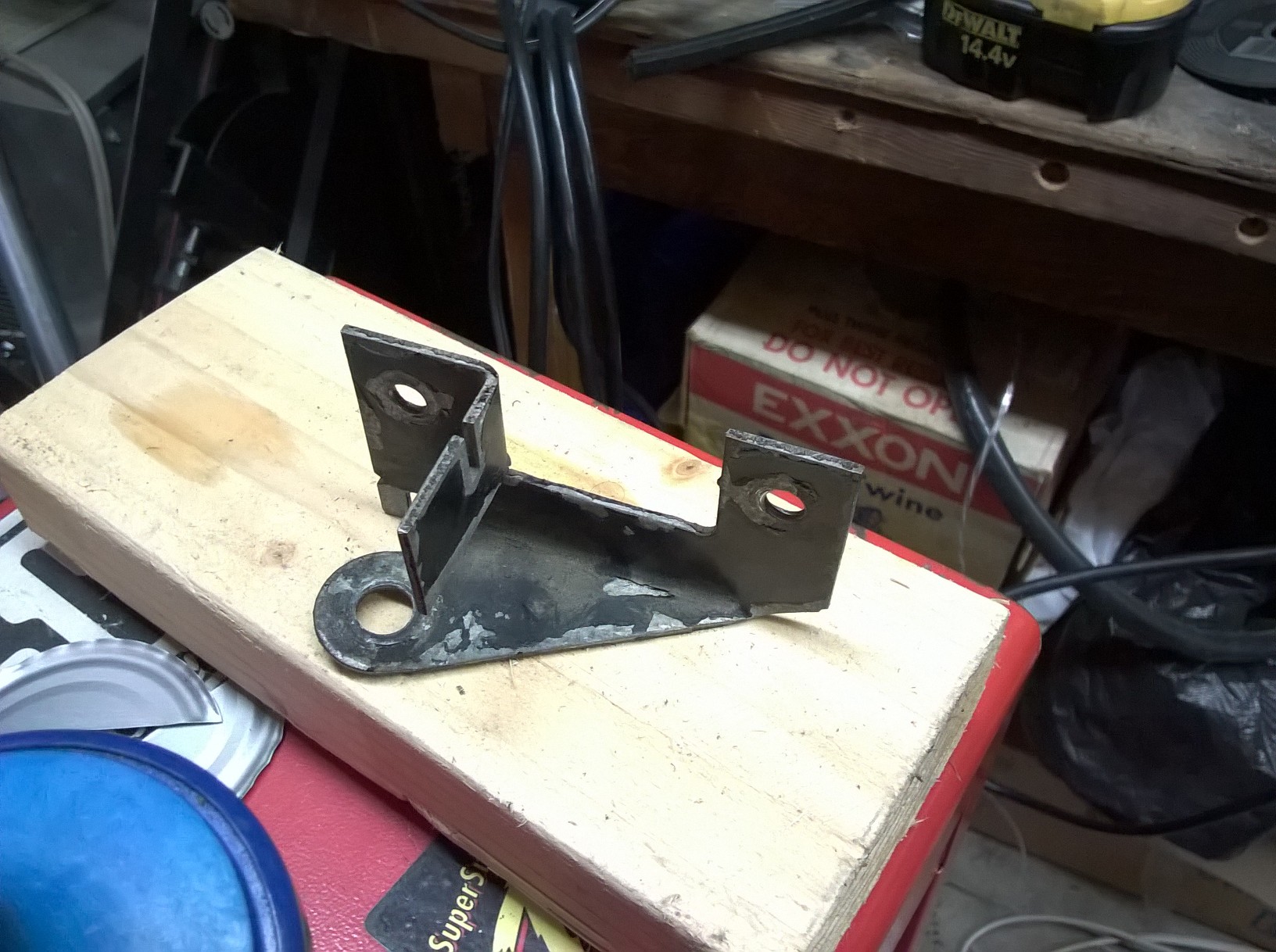

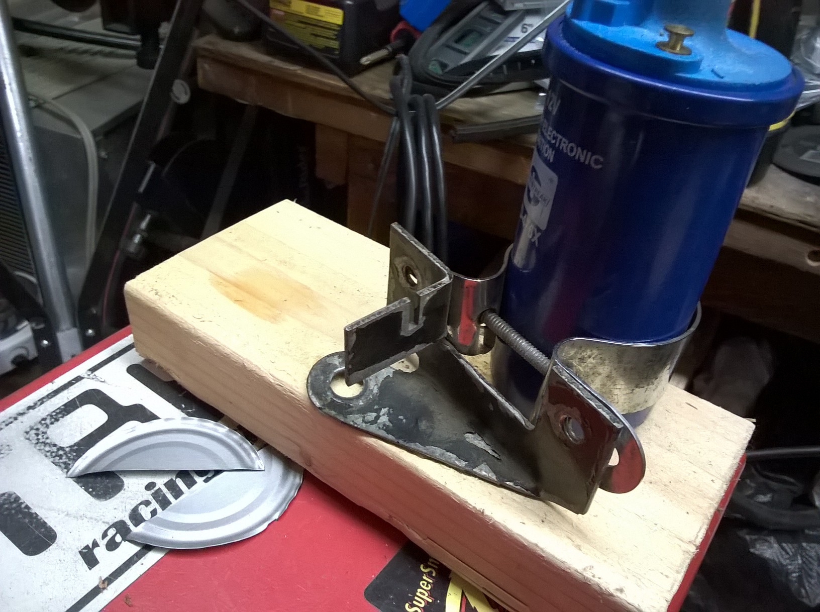

Well, I had a custom mounting from the P.O. for the canister coil and I was able to modify it to fit the e coil prettry easily with a cut off wheel and my bench grinder.
I then just drilled two matching holes for the smaller bosses on the coil and it's very snug.
It was a tight fit, on account of the forward vacuum hose but it's tight and installed now. Since I moved the distributor when I added that alignment tab I'll re-time the motor to spec.

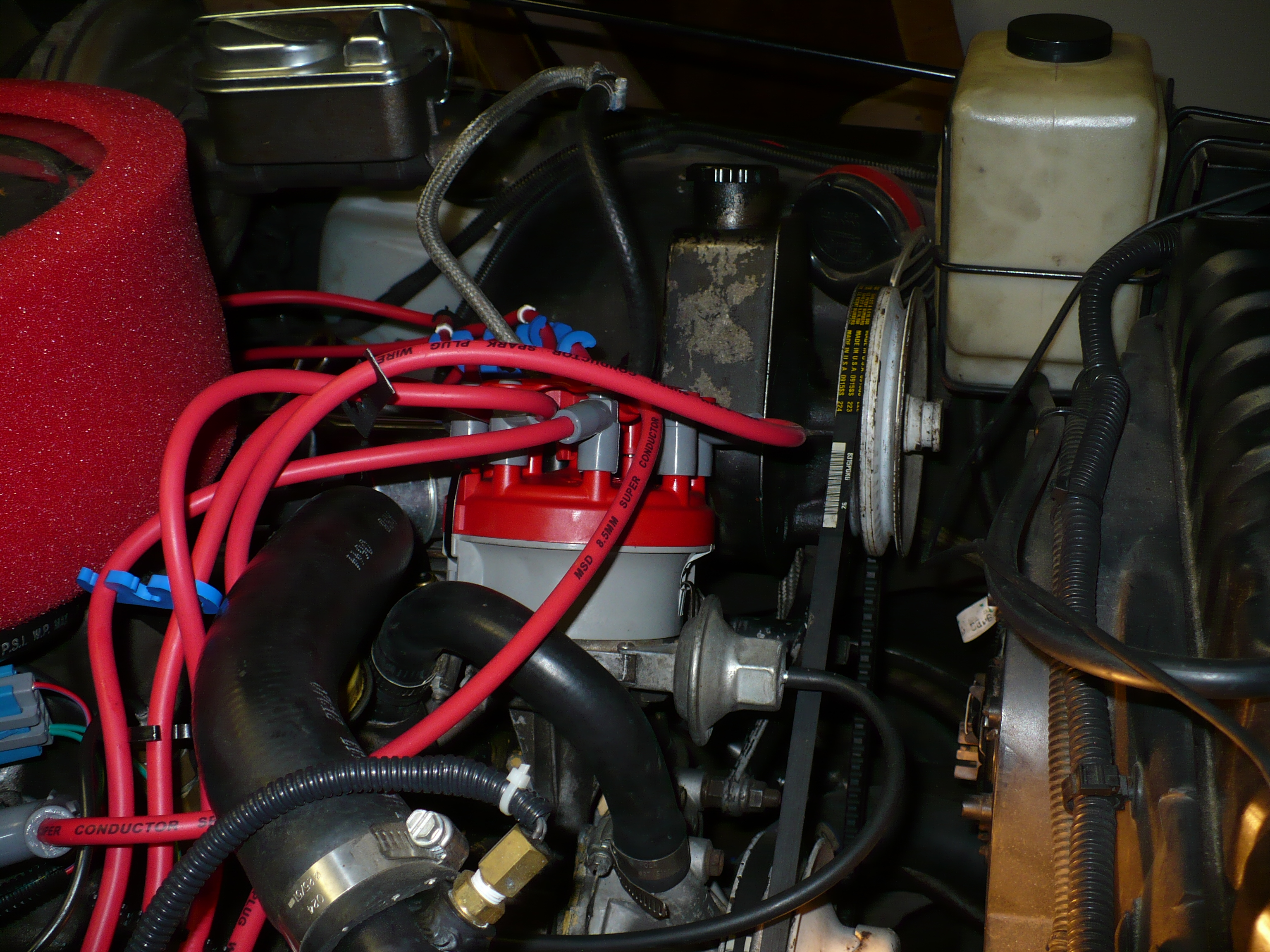

I just ran across a photo of the stock location of the spark plug wires, I wish I'd have seen that before I began this adventure. Mine are kind of messy, but I'd been advised to seperate each wire as far as i could. I guess these old AMC motors are right finiky, the Chevy 350's I'd run in the past 35 years were not so.
