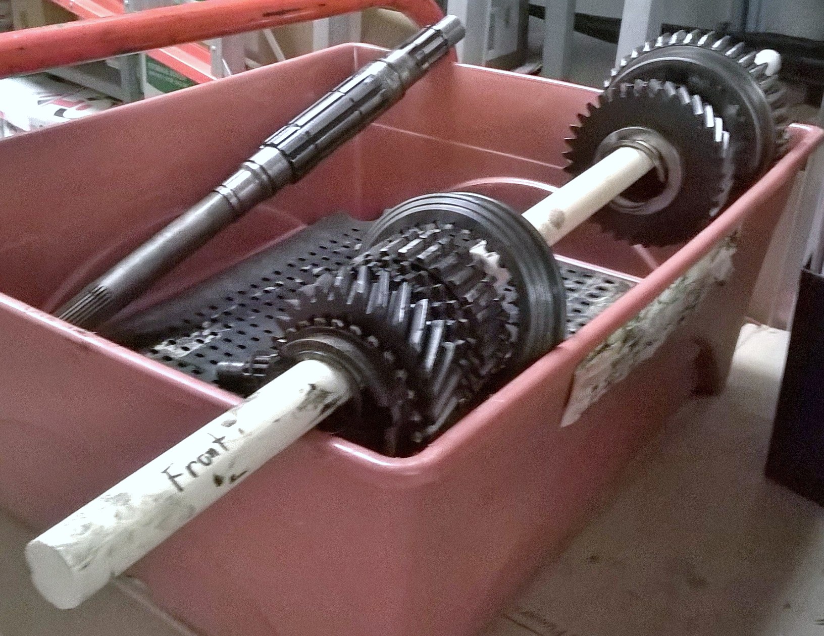

Meanwhile I re-read the Moses Ludel rebuild book and he offer's some additional photographs so I thnk I may be on my way. Going to get and overlength dowel to keep the gears, synchronizers, washers and such in order and oriented properly. Also when I first got going on this I found at Hab for Humanity a large shallow plastic tub to keep everything together. First though I have to clear access to that part of the garage and clear the workbench so I have room to manouver.

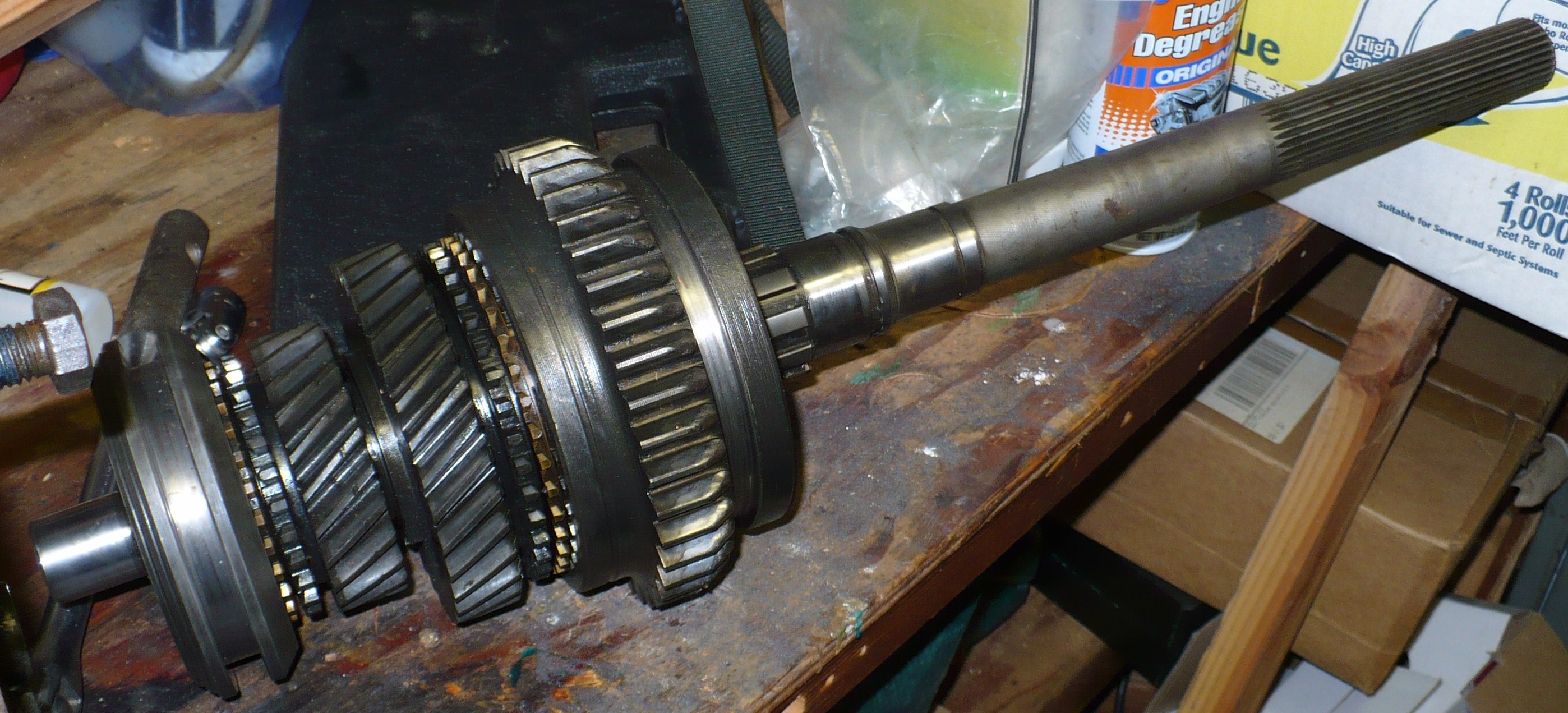

Got the mainshaft gear assembly out of the case and the input shaft which was a small PITA on account of the length of the mainshaft and case clearances

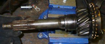

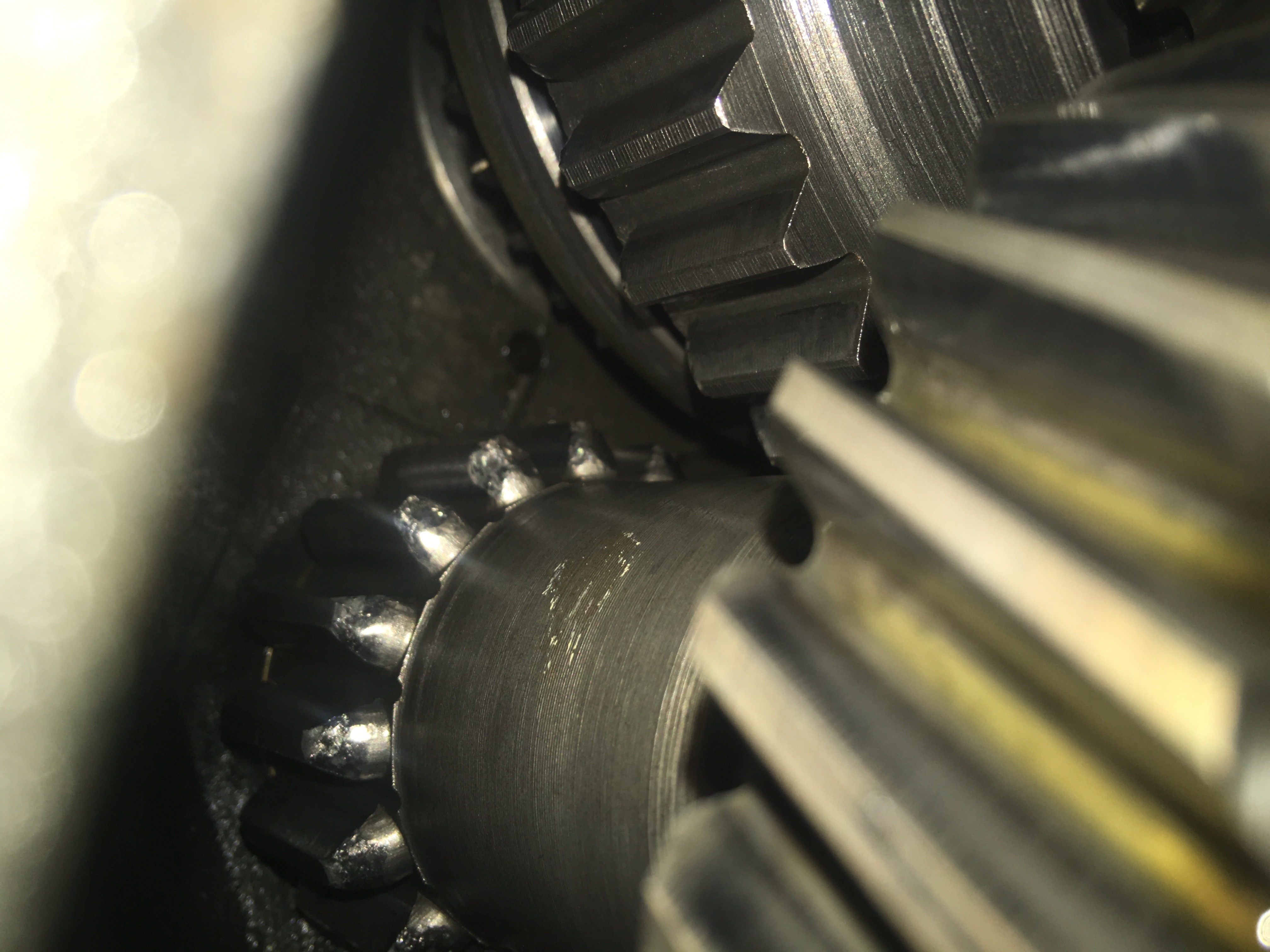

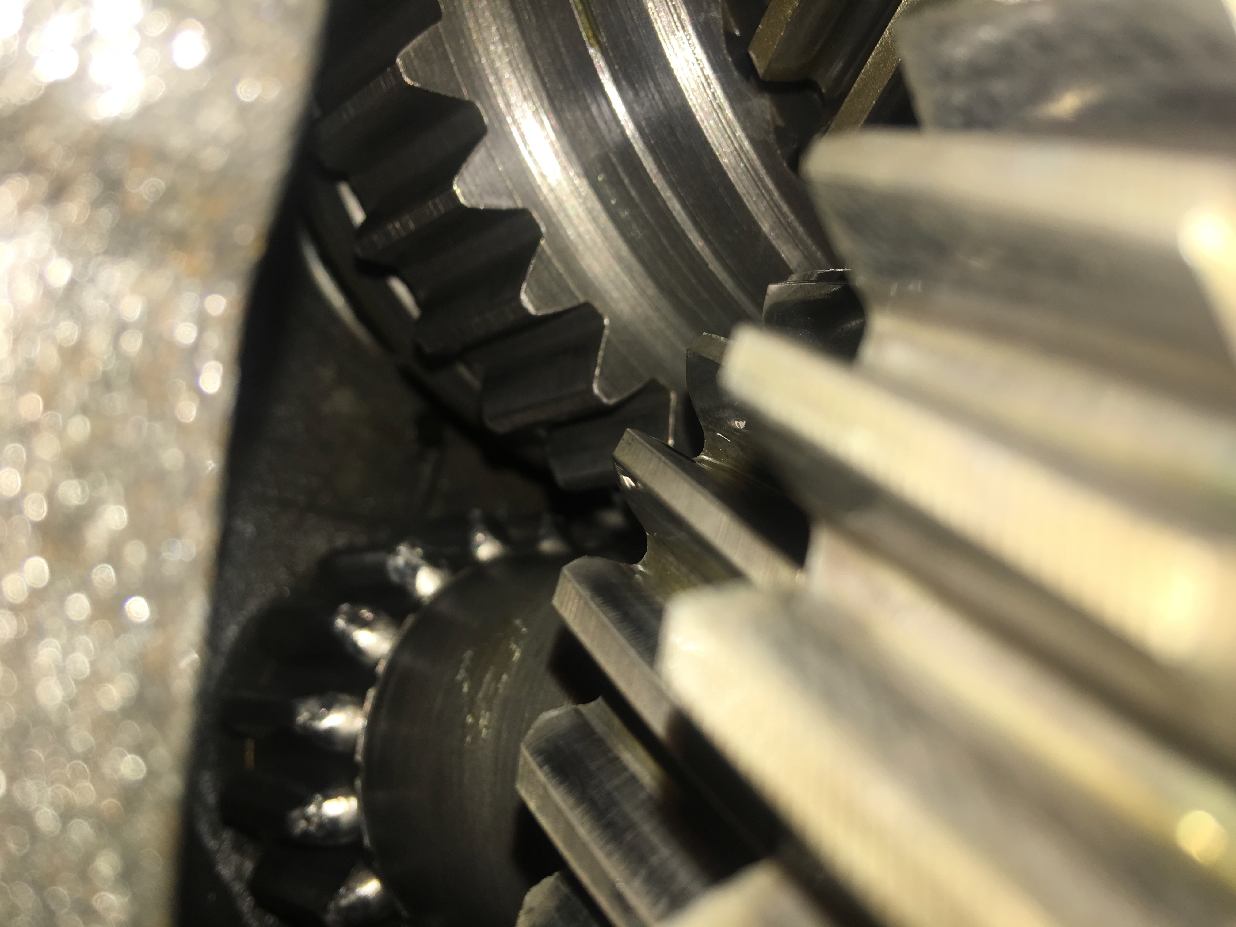

The input gear (that matches the length of the AMC 360 input) seem to be in good shape

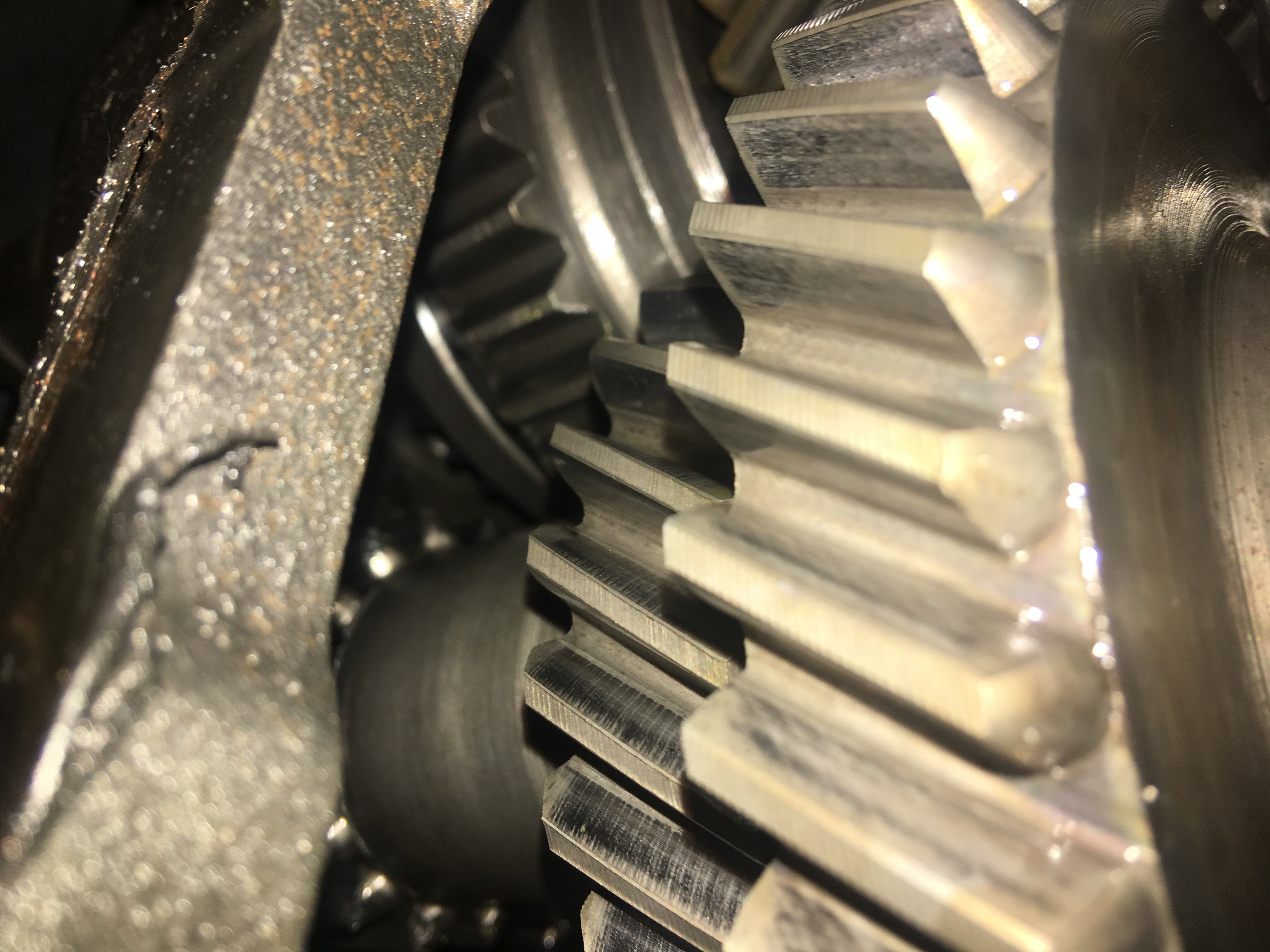

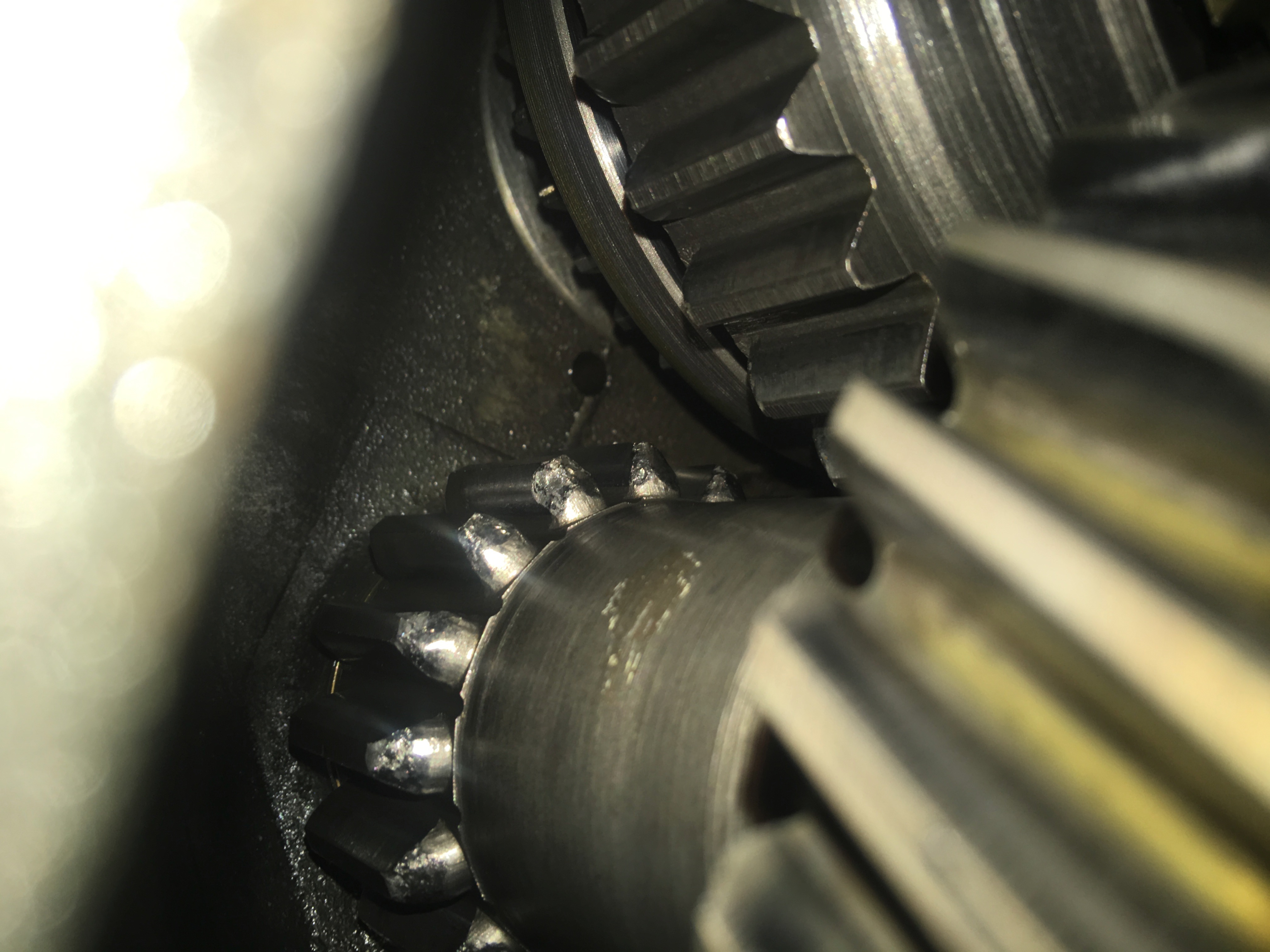

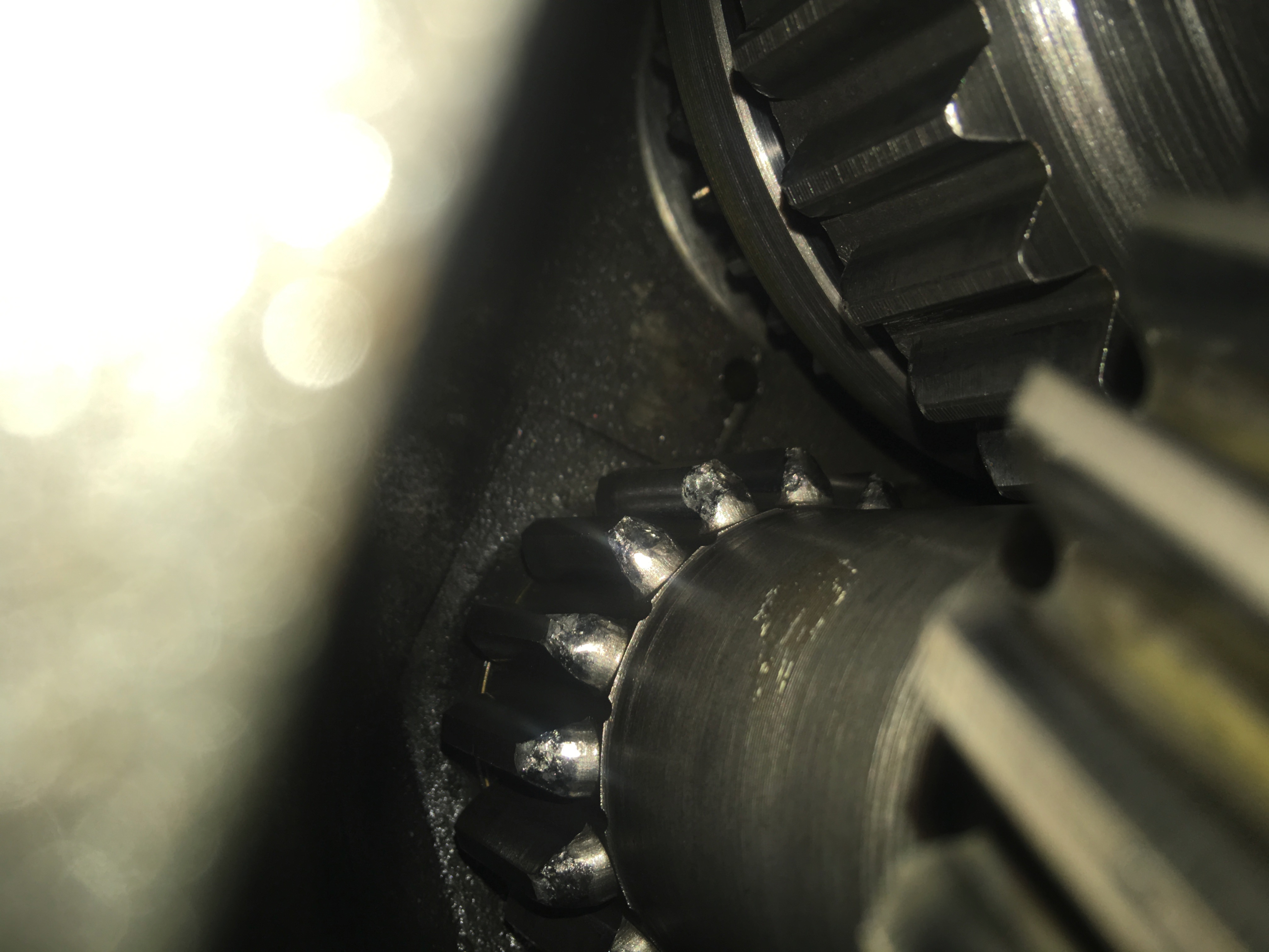

but the rear end of the countershaft and the reaverse gears look to be compromised. I may have to go all the way with this rebuild.

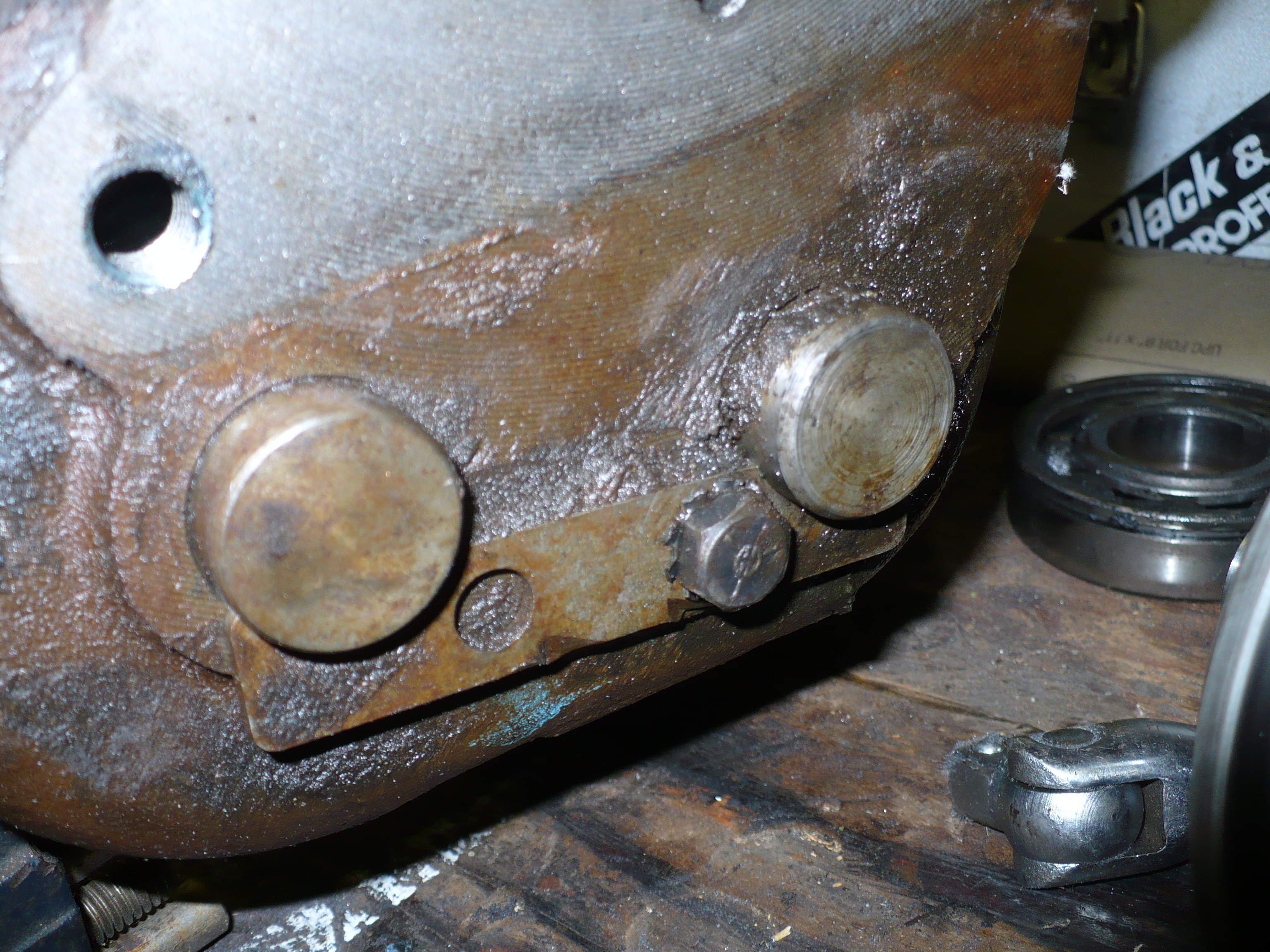

and I've got to firgure out how to remove these shaft ends, I removed the lockplate and now it's on to the shafts.P1060855.JPG

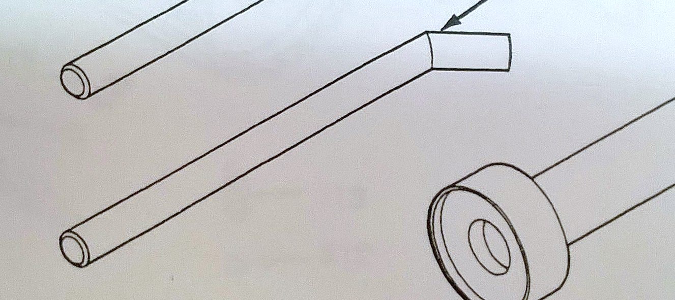

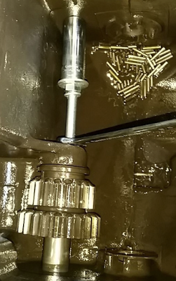

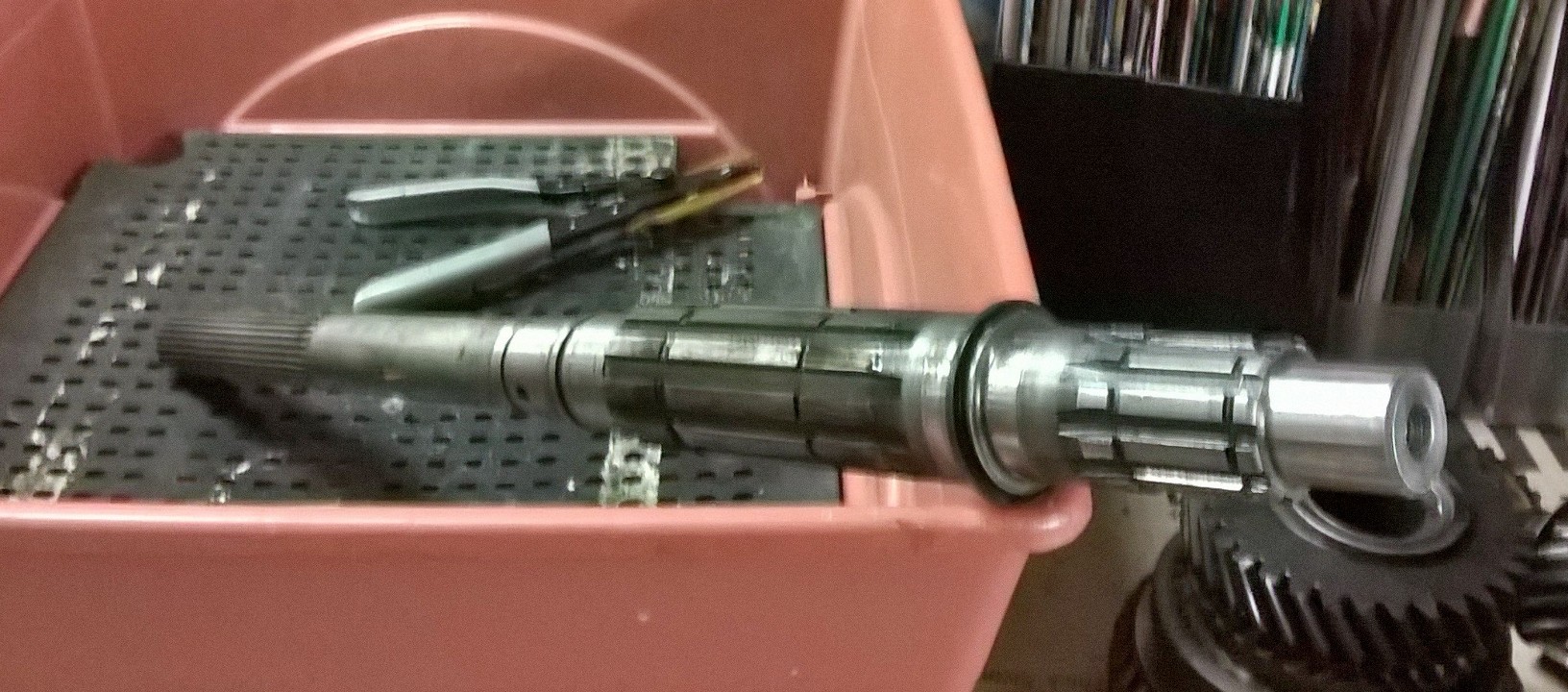

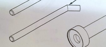

Made a little progress at work, I brought the tub from home and the el cheapo snap ring pliers and had at it. Luckily it all came apart without too much difficulty. Apparently I have to use some sort of angle drift to tap out the reverse idler shaft. Going to see what I can find. Unless I can just grind an angle to a standard flush drift, if that's what they mean.
The Tremec book mentions an angle drift to remove the reverse idler shaft, but I've never seen one of these;

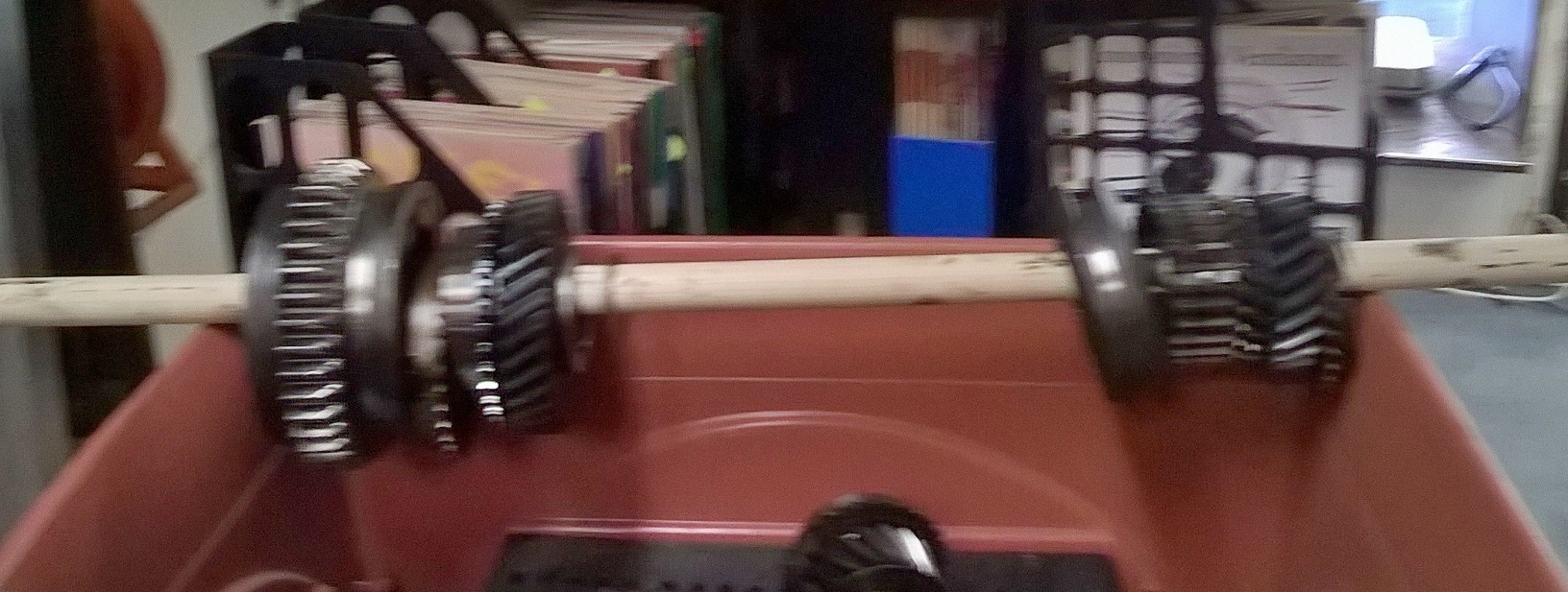

I did get the gears on a 1" dowell so to keep them and their orientation correct.
I'm seeing gears from www.ampdistributing.com and their prices seem resonable, has anyone used these guys? I looking at Second (&1st) Synchrozizer gear, reverse idler gear and countershaft aft gear or complete assy.
Well I stopped by NAPA to see if there was a shorter or longer drift but all they had was 6" or 8". I got a 6" in hopes of having clearance in the case for the drift and mallet but it was too tight. I tried doubling up the two drifts and I did get a few good strong smacks but for lack of calipers I think it only moved 1 or 2mm at most. The countershaft came right out by contrast for lacking a pilot shaft a few roller bearings slipped out but as these come in the rebuild kit I'm not too concerned at this point.
No word from the Craigslist guy in Portland, but I'm in no rush on this.
What do you guys think of this idea to remove the reverse idler shaft?

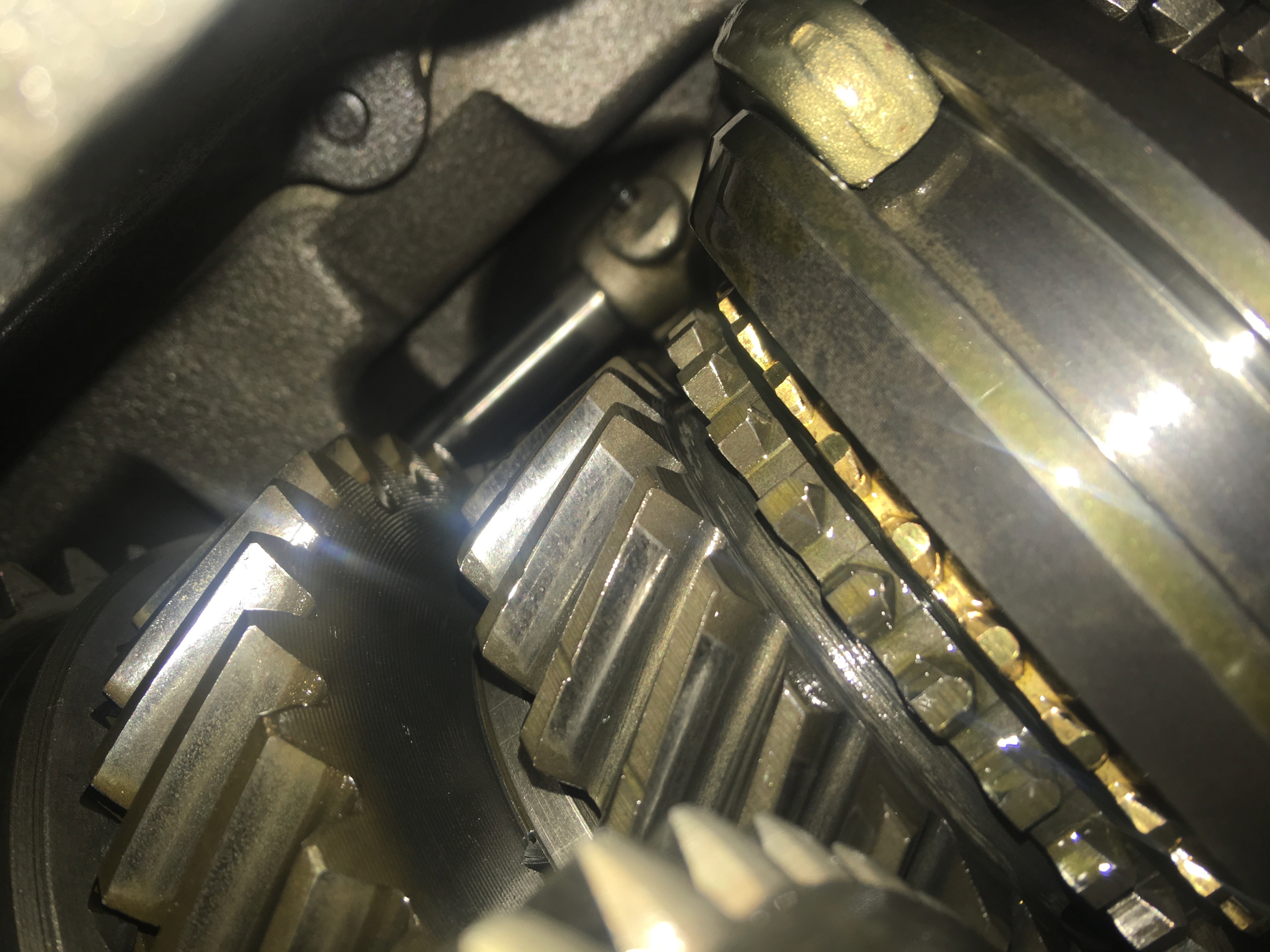

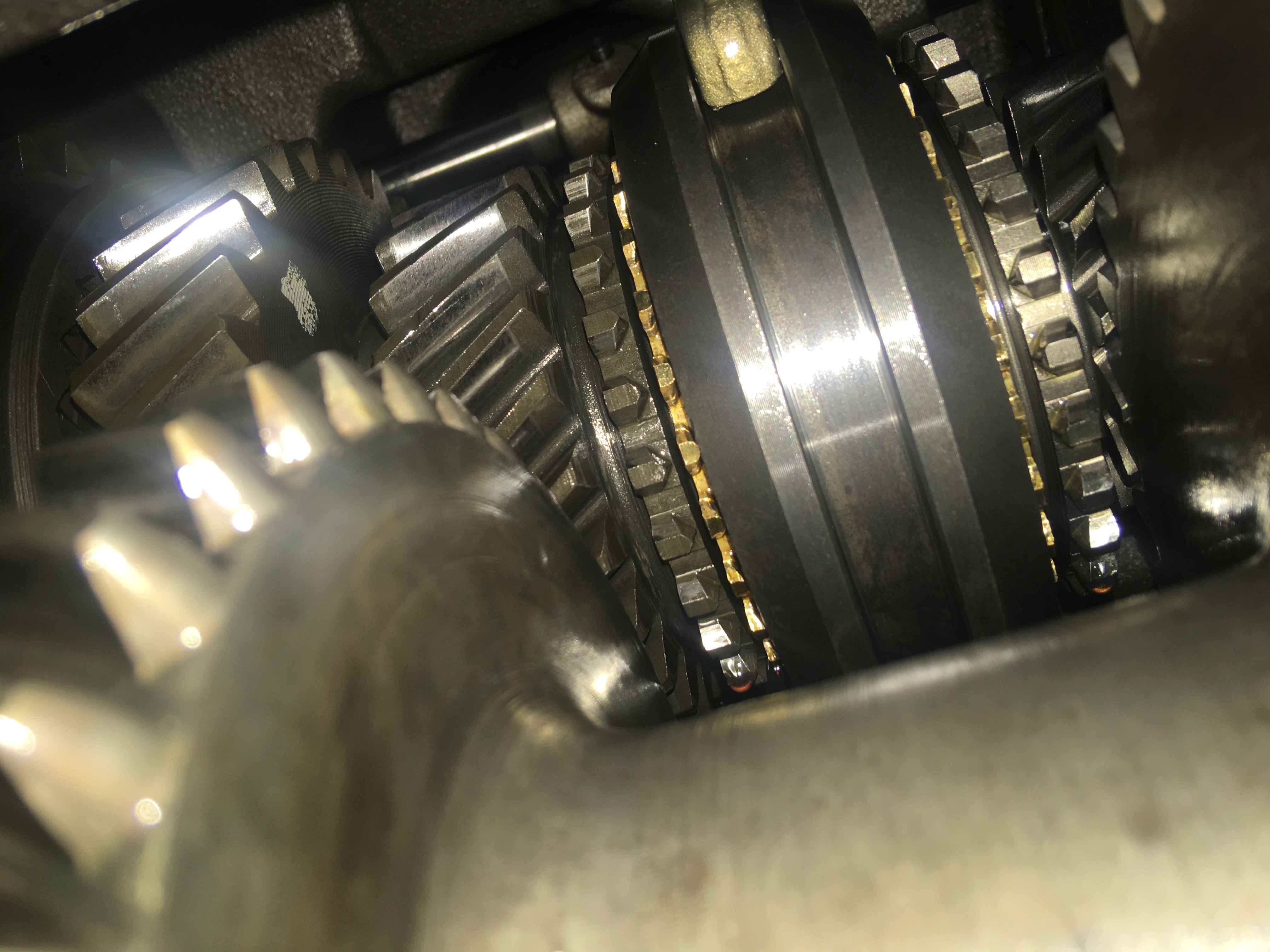

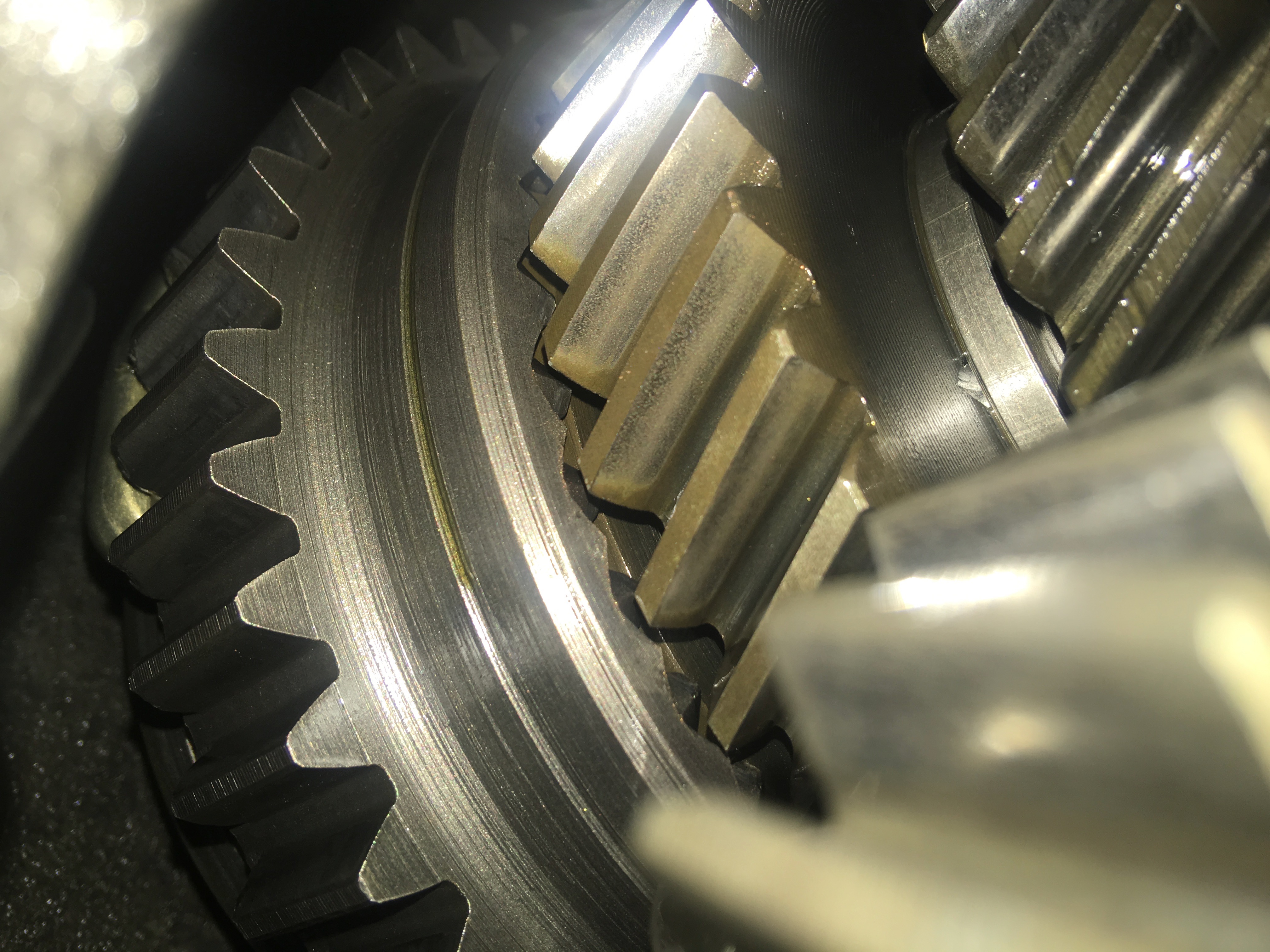

The craigslist guy up in Portland sent me some pic of the internals of his '68 T18 and it seems to look a damnsight better than mine with regard to the Reverse Idler Gear and 2nd & Low synchronizer ring gear.
Okay the CL transmission is mine. I'll compare the gears on the mainshaft when I get it home and choose the best for the conversion.
